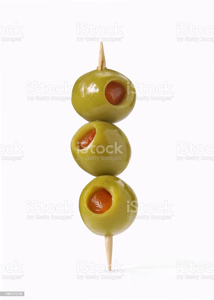

I don’t really think this picture looks that tasty but for the olives, you see there’ve different amounts of gloss, bit of a bump map and a translucent material I think, but I’m not too much into olives rendering, nice project though.
